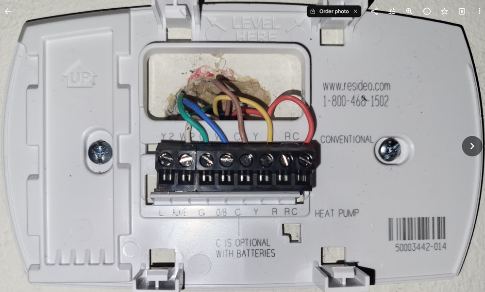

@Patrick_Caezza: the requested photo:
Which I believe is:
White: W2 - AUX/E Brown: C - C
Green: G - G Yellow: Y - Y
Blue: W - O/B Red: R - R
My primary question remains: what are the choices I must make during the setup/configuration of the Nest to make it work?

12-28-2024 04:55 PM
It's impossible to have a cheat sheet as every install is different even when using the same equipment.
The wiring would be something like this.
White - AUX/E to E (set as AUX heat)
Green - G to G
Blue - O/B to */OB
Brown - C to C
Yellow - Y to Y
Red - RC to R (jumper not needed)
