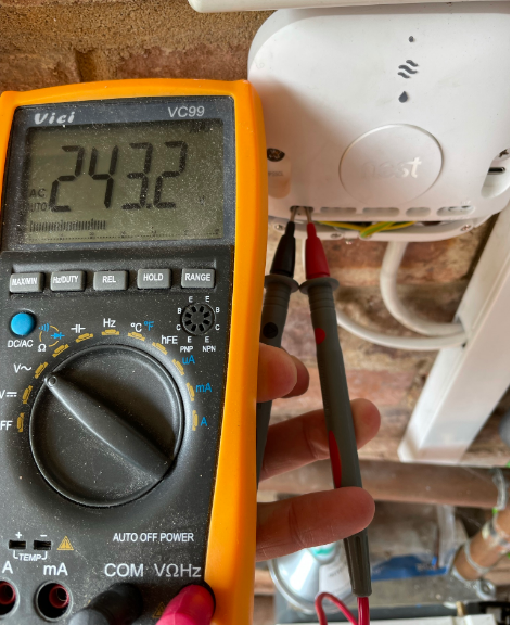

I had a 3rd-gen Nest thermostat fitted in June 2020 and it's been working fine until last week.
I discovered the thermostat was off, and when I inspected the Heat Link, found its light was off. I checked the input terminals on the Heat Link and 240V was present. 0V on the 12V output terminals.
I tried pressing the button to active manual mode. Nothing happened. Also when holding for ten seconds, nothing happened. Holding for 30 seconds, nothing happened.
No recent power cuts. No evidence of a wiring error. No recent service or maintenance on electrical, plumbing or heating system.
Looks like the unit is dead. Could you please assist?
