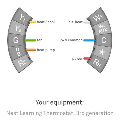

Hello,
I have a dual fuel system with a heat pump and a forced air gas furnace. Nest has been working great for the past few years with gas furnace. This is the first winter the heat pump has been in use. When the temperature drops below - 8C the heat pump stops heating, the heat pump fan doesn't run, the furnace fan continues to run but blows cold air and the indoor temperature drops. This tends to happen late afternoon after the thermostat switches from 17C to 18.5C, after that I usually change over to alternate heat and switch back later.
The installer doesn't seem interested in resolving this issue and blames it on the thermostat. Given that this is a new system I tend to believe them but very disappointed that they are not into trying to fix this since they were aware before they took the job that I had a nest unit. They did look at the heat pump once when it wasn't exhibiting the issues as it was not a cold day and were able to go though a defrost cycle and begin heating, the technician had said he'd like to see it when it's not working but after multiple requests they have not taken a second look.
I tried turning off various settings with no results and I've reset nest to factory settings.
Heat pump model: ICP TSH6 -International model- and is equivalent to Tempstar TSH6.
Any suggestions on how to fix this would be appreciated.

PylonSquelch
Looks like a wiring problem. Found answer on a A1 HVAC video below. Techs put alt heating wire in W2 alt. changed it to W1 and followed video for duel fuel setup. Currently testing.
https://youtu.be/aAluyOpVzu0
Nope, after the morning heating, the unit went back to the same behaviour. Problem not solved.
After reading some other forum posts it would seem this is a update issue. Would be nice if my system were magically rolled back to an older version as someone suggested happened to them.
Also, I set the system up with single fuel, running heat pump only. I removed the white W1 wire and reset the nest to factory. Ran fine in the morning but after the scheduled temperature increase late in the afternoon there was cold air from the vents and heat pump fan was not running.
