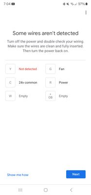

I am get nor detected for the white wire. I have performed a reset, stripped the wire on both ends and reconnected. I still get not detected

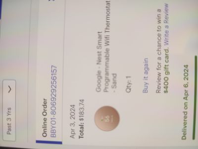

Google nest smart programmable wifi thermostat

The y wire shows Not detected now
