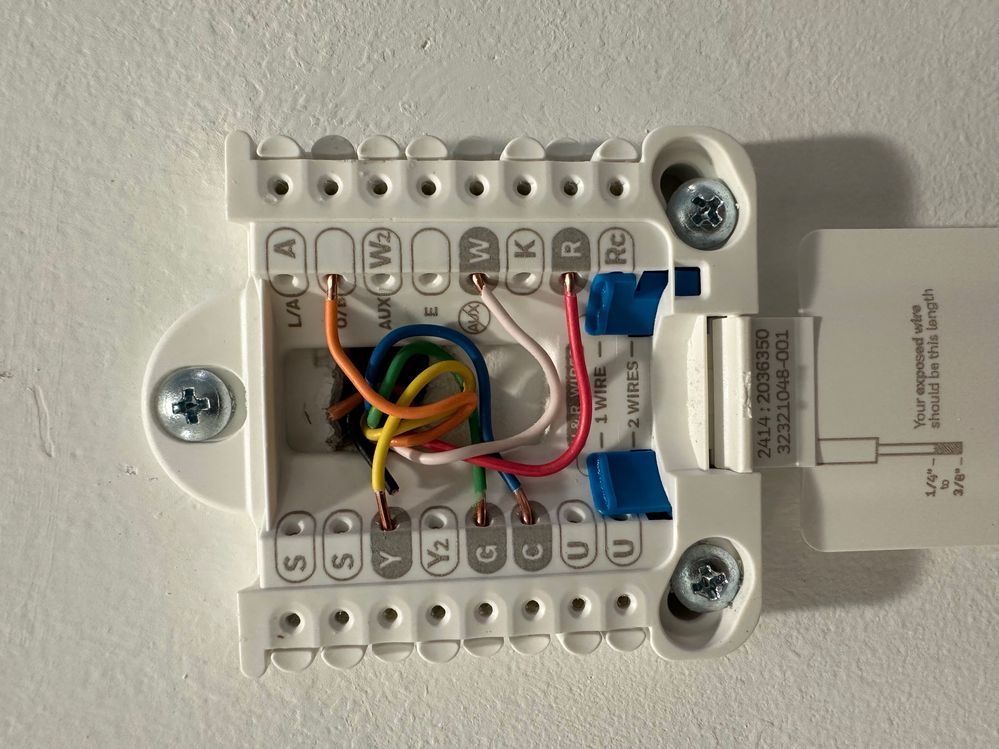

how about taking a moment to upload a picture of your nest backplate showing where the wires are attached and the picture you took of the old thermostat before you took the wires out so I can compare them and see if a mistake has been made.
Huh-me
The first picture is one I took of our original thermostat.  The second picture is a stock photo, but it is exactly how I wired the Nest including the wire colors.  Again, thanks for your help.
@Huh-me
that stock photo is not very good only because the fact that two of the wires are not properly inserted. Make sure that all your wires the bar copper is perfectly straight and flat if you will and fully inserted so that the tab stays down when you let go of it.
the thermostat to 10 that stock photo is a Nest 2020 series and does not have W2 auxiliary heat capability.
