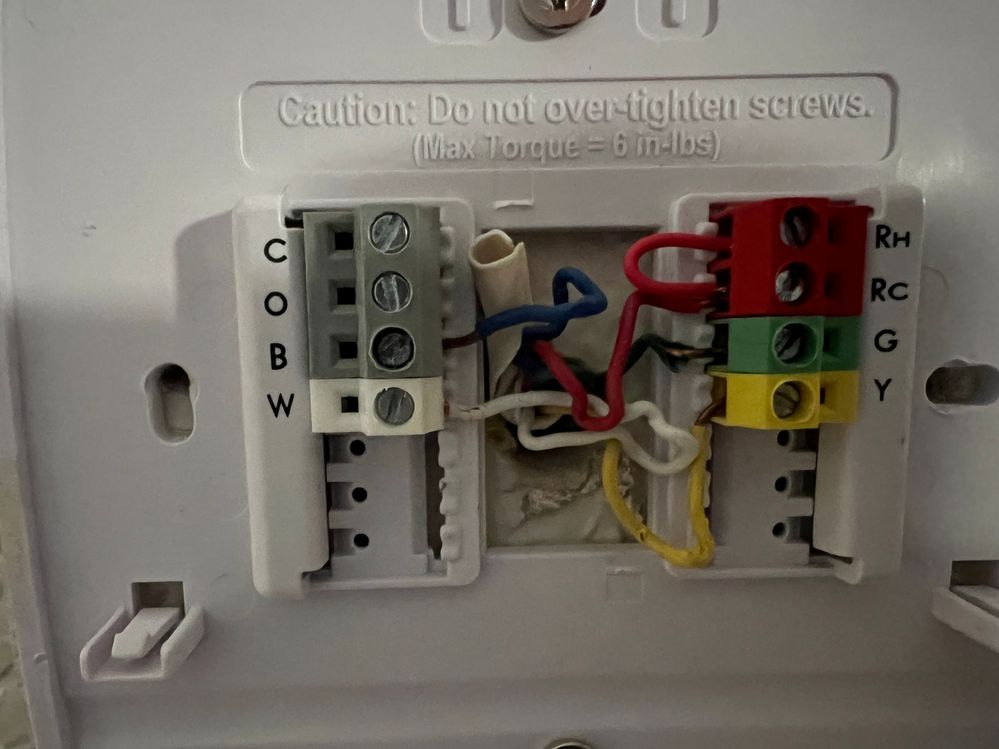

@Nest  I have a Rheem Classic Series Package Gas Electric HVAC Unit  RGEA15 Series Model # RGEA15 048 AJV XAA. The system documentation says it has a Heat Pump a Duel Fuel System with Gas/Electric. I purchased the Nest 4th Generation Learning Thermostat to replace a Pro1 Model T705 thermostat. The wires into the old Thermostat were
Red - Rc (With a Jumper to Rh)
Green - G
Yellow - Y
White - W
Blue - B
There was a Jumper between Rc to Rh. So a total of 5 wires. Initially I set up the wires on the 4th Gen as follows:
Red - Rc
Green - G
Yellow - Y1
White - W2/Aux
Blue - B
The system in cool or heat will start and then immediately shut off. I have tested the Red wire and have a constant 24 Volts, but I've been told I need a C wire power adaptor, or a Nest Power Connector placed at the Unit itself on the roof. Are the C wire power adaptor and the nest power connector the same thing? The power connector seems more complex as it appears to install at the main unit on the roof. I have replkaced the old thermostat and the system works fine, so this has to be some communication software issue right?

@SuperstringX
Post a picture of the original thermostat's wiring.
This is a photo of the old thermostat wiring!
