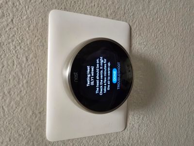

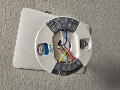

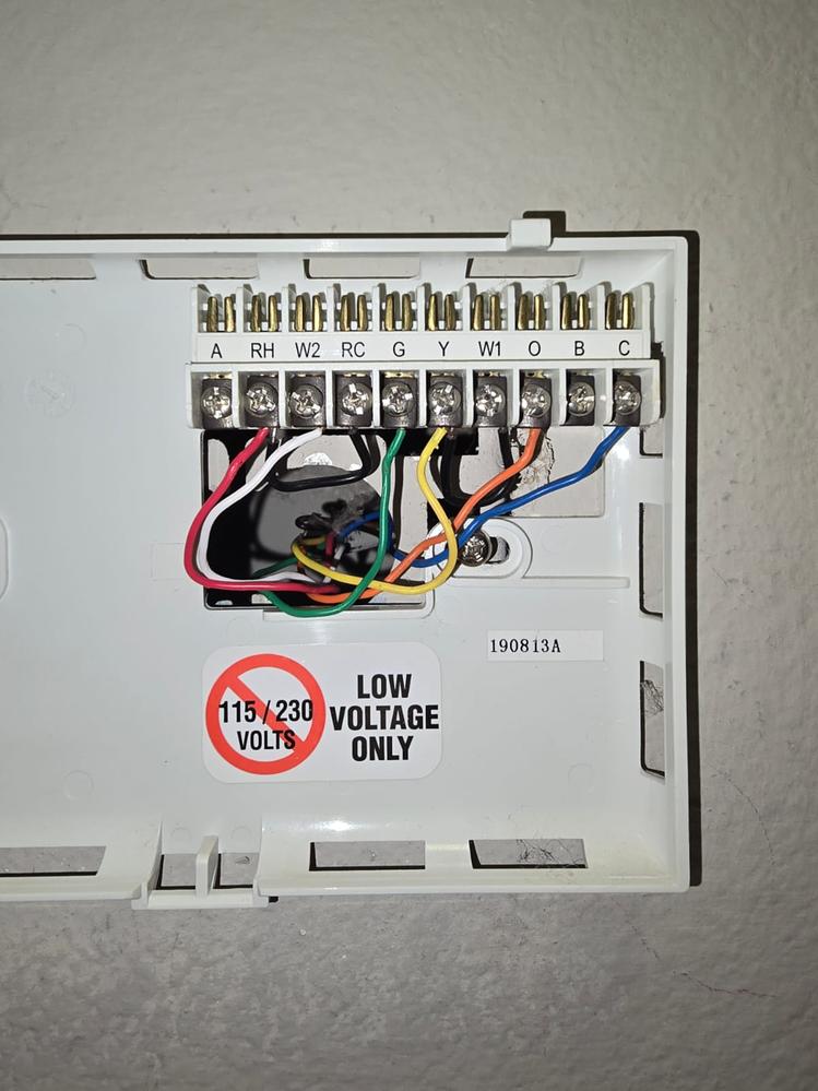

I installed my Nest 3 weeks ago, and heating was fine, but today I've tried many attempts, and when I switch to cooling mode, it sends heat through the vents, which led me to this forum. Maybe someone can take a look at the previous wired controller and spot the mistake.

I appreciate the pictures you provided me with the wiring of your Nest Learning Thermostat. To get a better understanding of the situation, please help me out by answering the following questions:

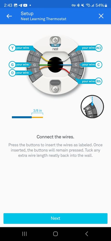

I would make a couple of changes to how you wired the Nest.
Red - RH to Rc (jumper not needed)
White - W2 to W2 (set as AUX heat)
Green - G to G
Yellow - Y to Y1
Orange - O to OB
Blue - C to C
I see that you are in an apartment. Is there a furnace/air handler closet there? If there is, take a look inside of it and see if you can check how the thermostat cable is terminated inside of the unit.
hey @Patrick_Caezza , tnx for the help

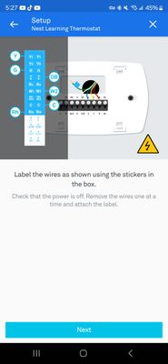

so iv done all the setup from zero, and didn't have luck still all heat, im going to add a bunch of pics of the process in order maybe you guys can spot something im doing wrong or an alternative setting it up, also gonna add pics of the closet if you like me to open something and take more pics just let me know , not a pro but im an engineer so i don't mind messing up with stuff just point me in the right direction .

@maucp
Looking at the schematics you include makes me wonder if you even have a heat pump.
Can you post a picture of the thermostat cable wiring in the furnace/air handler?
