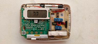

Hi need help to see if my thermostat is compatible with next thermostat

@Vinh5035
Yes, it is compatible.
Just match the wire labels on the original thermostat with the Nest thermostat, and you can ignore the jumper between the two R terminals.
I always recommend that a C wire be installed if an extra wire is hidden, or you can install the Nest Power Connector.
