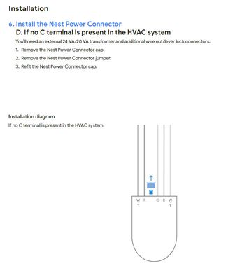

Boilers are a pain to set up for use with any smart thermostat correctly. You're going to need the Nest Power Connector and an external 24vac transformer.

@Mike222
I don't see anywhere to connect a third wire. That's why you will need the external 24vac transformer.

Your diagram with the extranal 24v transformer are not to clear.
I was not able to find the manual with that wiring on the WEB.

@Mike222
Here is a link to the Google Nest Help article about the Nest Power Connector.
At the bottom, you will find links to the different installation guides.

@Patrick_Caezza
Good, I found the right installation guide.

Mike222
@Patrick_Caezza
I have finalized the installation yesterday morning. It's finally working with Nest power connector and the 24 V transformer.
