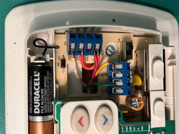

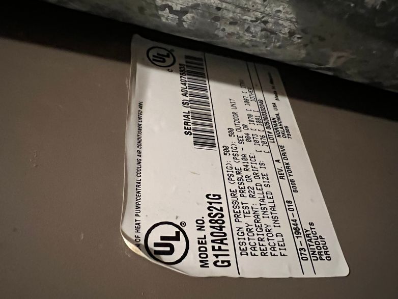

Is my new Learning NEST Thermostat compatible with my existing HVAC?
JeetV
Thanks for any help.
11 REPLIES 11
Yes, your current thermostat is compatible.
Try this wiring
Green - G to G
Yellow - Y to Y1
Red - RC to Rc (jumper to RH not needed)
White - W to W1
I always suggest that you installed a C wire if you don't have one, you can do it if there is a spare wire or you can use the Nest Power Connector. This will keep you from having problems down the road

JeetV
Finally hooked it up yesterday..
My c wiring is incomplete..although c (blue) wire was unused at the thermostat end , it wasnt connected at the HVAC end..and also there was a red and white wires connected to c wire connector..so i wasnt sure how to connect that..
Got the nest thermostat connected without the c wire..
When I conncted R ro Rc , the thermostat was not powering up..but when I connected R to Rh, it powered up and it is working..
I tested both cooling and the heating system..it seems to work, atleast so far..
Although, Nest says there is no need to connect the c wire to the thermostat, the advice I am getting is, it is better to get it connected..i certainly dont understand this..but i did learn that the c wire supplies the 24volt to the thermostat..if that is so, why is running now? Obviously i am just getting to learn about it. I will appreciate if someone can explain this.
Thanks...Jeet
