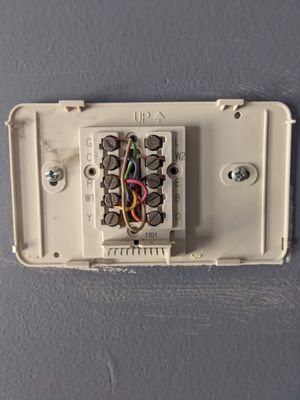

Hi guys, I was trying to update my thermostat but I have a problem with the wiring. I have 7 wires ( H1, H2, G, R, O, E, C) buy not Y. When I try to set the nest it said it got a missing Y wire. My old thermostats are working fine without that Y wire. Anybody knows what can I do? Thanks

Post a picture of the original thermostat's wiring here

Try this wiring
Green - G to G
Blue - C to C
Red - R to Rc
Yellow - W1 to Y1 (jumper to Y1 not needed)
Orange - O to OB
Black - E to */OB (set as Emergency heat)
White - W2 to W2

We'd like to jump in here and check if you've seen Patrick_Caezza's response. You could try the wiring configuration and let us know how it goes by replying to this thread.
