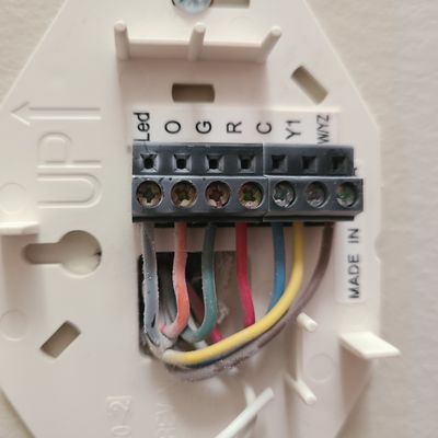

Just curious if this wiring setup will work with a nest or not.

Hi Rlee,
Thanks for reaching out. I'm sorry for the delay. I'd like to know more about it. Could you please share the photo of the wires that are connected to your HVAC control board? What is the make and model of your thermostat? Also, for more information you can visit this support article and try the compatibility checker.

Hello!
Thank you for replying, here are the control board photos.

The thermostat and pump are ClimateMaster, the actual pump is Model GRV024BGC30CRTS

@Rlee, thanks for the follow-up information. Your thermostat wires are compatible with our Nest Learning Thermostat 3rd generation. Below is an image on how you should connect your thermostat wires to the Nest Learning Thermostat 3rd generation's base.
You won't need to connect the thermostat wires that go to the LED terminal of your current thermostat since they are not needed anymore. Also, here's a guide for the installation and set-up of a Nest Learning Thermostat 3rd generation.
