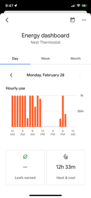

We have the nest thermostat that we installed. The unit says it’s heating but is not and the fan is constantly running and won’t shut off.  Also it says we have electric heat with a heat pump for auxiliary heating but we have gas forced air.

Tonight the thermostat was set at 68 deg, it was 67 in the house. The thermostat said it was heating but only the fan was running constantly. Never heated or got to 68 deg. Need to know what is wrong
