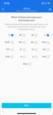

Hi,i am looking to setup nest learning thermostat for my home and before buying the product ul,I thought of checking the app for compatibility.
In the setup app,I could find 3 wires out of the 7 which i can see in my wiring
And then i got a message that the thermostat is not compatible with my house.
Can someone help me and let me know if i am missing something?

  • The brand name is Honeywell and i am not able to see the model number anywhere.
Sidd
JenniferV
Thanks for the photo. It looks like your current thermostat is using a proprietary wiring. Proprietary systems aren’t compatible with Google Nest thermostats. However, some proprietary systems can be rewired by a pro installer to be compatible.
