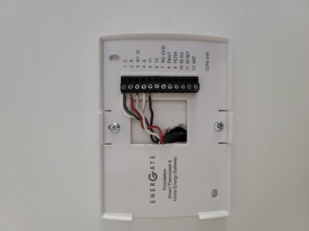

My furnace use natural gas and I have R, W1, Y1, G, and C&G jumper wire installed. This C&G jumper wire is kinda weird, because If I use other short wire as jumper it does not work. So I had to use electrical tape to this short jumper wire with the other wire since Nest's C & G is longer than that jumper wire.  So when I did that it worked for 3 months and Nest was not working near early June.
I have attached picture of my previous thermostat's wire setup, because I am currently using the previous one right now. My previous thermostat is still works great, but Nest doesn't.
Thank you Eudardo in advance

Thank you very much for all the information provided! Regarding the wiring, I'd like to point out that the jumper you used on your old thermostat between G and C is not needed for the Nest Learning Thermostat (4th gen), as it is designed to work without jumpers. For this reason, I'd like to show you the correct wiring you should use:
  • Red - RH
  • White - W1
  • Black - Y1
  • Green - G
Keep me posted.
Eduardo
