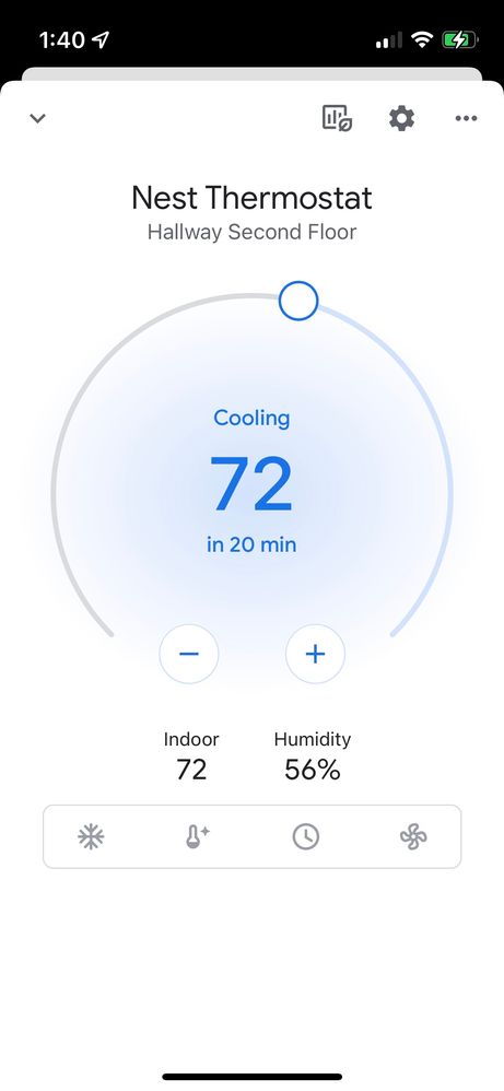

I just installed a Nest 1st Gen Thermostat over the weekend and am having the same problem. Set the desired temp to 72 last night and indoor temp was 72 yet still said it would take 20 minutes to reach 72. Here is a screenshot. I keep a little digital thermometer by the bed, it said the room temp was 66 which is very possible because the thermostat is outside my room in the hallway. With the a/c just running and running, my room was freezing! Anyone have advice? I'm already thinking about returning the Nest because it just isn't worth it if my electric bills are going to increase.

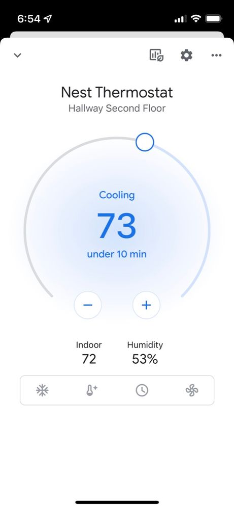

Also attached is a screen shot of the app, showing the indoor temperature as 72, the thermostat set to 73, and my a/c in Cooling mode and going to take 10 minutes to reach 73 degrees...which does not make sense at all if the indoor temp is 72.

Hi Ryan, I do use the schedule feature however I don't see how that can have anything to do with the problem I'm having. The thermostat is adjusting based on the schedule I have set, it just keeps running and running even when the set temperature is reached, and I have this same problem even when not using the schedule.
I will try the complete reset at the soonest opportunity.
Based on the photos I sent, can you confirm the wires are correct?
Also any thoughts on that app screen shot I sent that shows the indoor temp at 72 and the thermostat set to 73 yet still in cooling mode and indicating it would reach 73 in under 10 minutes (even though the indoor temp is already 72)?

The wiring configuration on your Nest Thermostat seems to be correct and like any other thermostats, Nest Thermostat has a built-in delay feature that protects your system from any problems. Check out this link to learn more about it.
