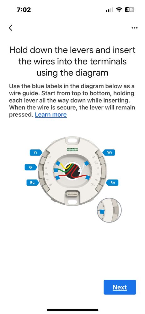

We have a dual fuel Trane heat pump with a propane back up and the system isn't working since install.  Right now I get no heat.  The HP won't turn on, nor will the furnace.  I've added the picture of the old thermostat and a picture of what Google says it should be.

@Bk911rsa
This is how you should wire the Nest.
Black - Y2 to Y2
White - W1 to W2/AUX (set as AUX heat) (Jumper to X2 not needed
Blue - S1 - tape off
Brown - S2 - tape off
Green - G to G
Yellow - Y to Y1
Orange - O to O/B
Red - RC to Rc (jumper to R not needed)
