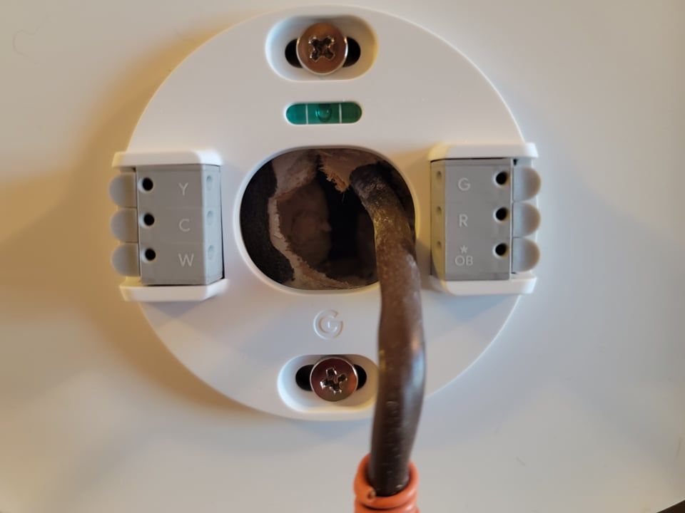

Nest Snow W1 and W2 wires
brodiew
Old thermostat used wires O, R, Y, E/W1, W2, G, C
Nest has connectors for Y,C,W,G,R, OB
The only one I am having issues with is the "W" connection on the Nest.
Do I connect the E/W1 wire, or do I connect the W2 wire?   Or 3rd option.... Is this thermostat even compatible?  I have swapped out thermostats a few times over the 11 years I have been here, and this is the first time I have run into this issue.
1 REPLY 1
sporfrog
It looks like the "Nest Thermostat" may not compatible with your system. That thermostat will support HVAC systems that use up to 6 wires.  Your system is using 7. The Nest Learning Thermostat likely will work,
Check the Compatibility Checker to be sure.
