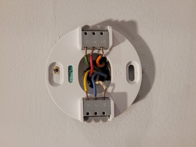

I'm trying to switch from an older 2nd Gen Thermostat to a newer 4th Gen. We never had any issues with the previous setup, however when I tried to install the new one I'm only getting "Some wires aren't detected" issue and after that "The C wire isn't getting power".
Since I'm just switching to a newer thermostat I thought it would be an easy switch.
Anyone know how to fix this?
Thanks
This is the old wiring
This is the new wiring
This is the error message

  • Ensure wires are fully inserted: The wires may not be making a proper connection with the terminals. Make sure at least ¼ to ½ inch of the copper wire is exposed, straightened, and fully inserted into each of the required connectors. If necessary, take the wires out, check them, and put them back in.
  • Check for stranded wires: Stranded wires can sometimes interfere with detection. If you have stranded wires, consider contacting a Nest Pro or local technician to replace or rework the thermostat wire setup.
  • Make sure the wires are not too small. The Nest thermostat requires 18 to 22 gauge solid-core copper wires. Any diameter smaller than that is too thin for the Nest Thermostat to detect. If that is the case, you can contact a Nest Pro or local technician to replace them.

I was able to connect the old 2nd Gen again so we wouldn't be without AC. I'll try to re-install the new one again this weekend and report back.

Just tried to install it a second time and everything worked without any issues. No idea why I got all these error messages the first time.
No further assistance required. TY
