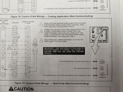

I have my nest learning thermostat connected to Lennox cbx32mv inside unit and Lennox xp21 outside unit.
The cold air is working working perfectly even 2 stage but the heat does not work for some reason.
Please Help!!!

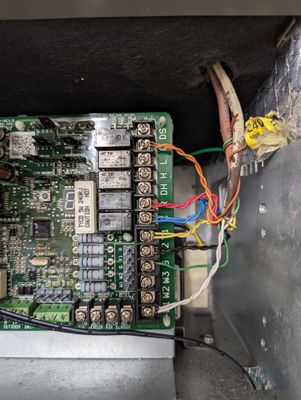

It appears that your thermostat somehow sends a signal to call for heat, but your system is not responding since cooling works. To make sure it's in the right configuration, do you mind if I ask you to send us a picture of your previous and current thermostat wiring setup?
Hey Rogelioleon0221,
Yes I still need assistance and here is the current wiring. I don't have picture of previous wiring but I know it was 4 wires since the thermostat was icomfort which is communicating.

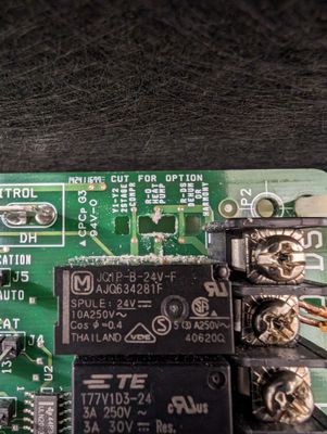

Rogelioleon0221
Lennox XP21 2 stage heat pump nest wiringLennox XP21 2 stage heat pump nest wiringNest learning Thermostat wiringNest learning Thermostat wiringCBX32MV Air Handler Nest wiringCBX32MV Air Handler Nest wiringCBX32MV Control board jumper required to be cut for Heat pump to work correctlyCBX32MV Control board jumper required to be cut for Heat pump to work correctlyManual explaining this jumper to be cutManual explaining this jumper to be cut
