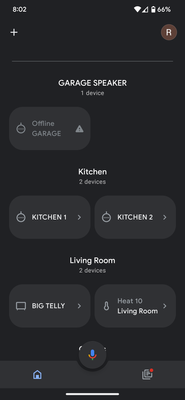

Thanks for the confirmation. Could you please take a screenshot of your Google Home app showing where your thermostat is connected?
Ritchie
Ritchie
I just downloaded the Google Assistant app, even though my Pixel 7 Pro seemed to have that functionality already built in. Opened a few menus, changed a few settings, now the Nest Thermostat works using voice commands on Phone and on Google Home mini speaker. Seems to be all working fine as I originally hoped for.
