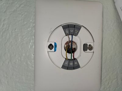

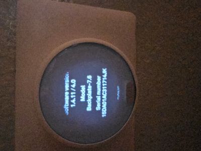

Thanks for getting back to us. Could you list down the power readings of your thermostat's VIN, IIN, PS-* under  Settings > Equipment > Power Info? Also, send us a photo of your Nest Thermostat wiring configuration so I can take a closer look.
This is so frustrating! The heating system worked fine for a few days as we set it at 70 and left it undisturbed. (We didn't lower the temperature even at night, when 70 may have been a bit too warm.) But last night the weather got down to low 30 and our crazy thermostat started acting up! It allowed the indoor temperature to go down to 64, which was too low for our comfort in the morning! I was up at 5am and tried to raise the temp to 70 unsuccessfully. The thermostat only showed that it would be 2+ hours. Right now it is 8am and still no heat! This is ridiculous!

Hello MemoSanchez,
I'm sorry for the late reply. Follow these:
  1. Move the W1 wire to the Y1 terminal.
    • At the breaker box, turn off the power to the HVAC system.
    • Move the W1 wire to the Y1 terminal then put the display back on the wall.
    • Turn the power back on at the breaker box.
    • Switch to cool mode but expect heat.
    • Check if the system runs. Some systems take time to start up so allow 5 minutes for the heat to turn on.
Let us know how it goes.
