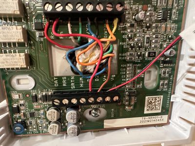

I have a 2 stage packaged ac and gas furnace with dehumidifier. System is blowing cold air when I run heat. I have changed the O/C setting and that didn’t help. When setting up the equipment, my heat option only allows electric which I think is my problem. Anyone have a suggestion?  Thanks.
@Markchartnett
Can you post a picture of the original thermostat wiring and one of how you have wired the Nest?
Also, the aux heat works when I test it.
@Markchartnett
Can you post a picture of the terminal block in the air handler?
Markchartnett
@Patrick_Caezza
see below. I can send additional pictures if you need them. Thank you.
