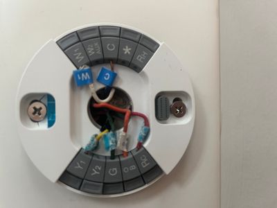

Hello, having the problem that the furnace is not shutting off when setpoint is reach on Nest 3rd gen learning thermostat.  Reading online, someone suggested bumping the nest up to above the inside temperature and then back down.  I believe this worked.  Is this a nest issue or a furnace issue?  I have dual fuel heat, primary is electric heat pump and back up is propane furnace.  We had this issue before but it went away.  Now its every day or every other day.  No error codes. I have not tried disconnecting from the wall plate but I will next time this happens.  Does not appear to have any loose wires and all the tabs are pressed.  I do maintenance on the system every spring and fall.  I can send picture of wiring. Thank you!

  • Can you please send me a picture of the Nest Learning Thermostat 3rd gen wiring?
Any additional details you can provide will be helpful.
Gabriela
Thank you. It started being constant two weeks ago but it has happened before in the last year ever since I got this new nest.  No other symptoms.  When the problem is occurring, it does not indicate that it is calling for heat.   It does indicate calling for heat when working properly. I don’t see an option to attach a photo.
GabrielaG
Hi
Thank you for your reply. I appreciate the picture and the information you provided me about your Nest Thermostat. I’m happy to continue assisting you right now.

We need to check if there is an issue with the backplate of the Nest Thermostat troubleshooting the OB terminal. If you feel comfortable, please follow the steps below.
  • Turn the HVAC system power off through the breakers.
  • Remove the Y1 and OB wires.
  • Turn on the breakers and treat the system as a conventional heating system.
  • Stop any call for heat or cool.
  • Turn on the fan and verify if it activates.
  • Put Y1 back, and swap the OB and G wires.
  • Turn the power back on the HVAC system through the breakers.
  • For heat pumps with O-orientation: Call for cool, but expect heat.
  • Stop the call for heat or cool, turn on the fan, and verify if it activates.
Let me know how it goes.
