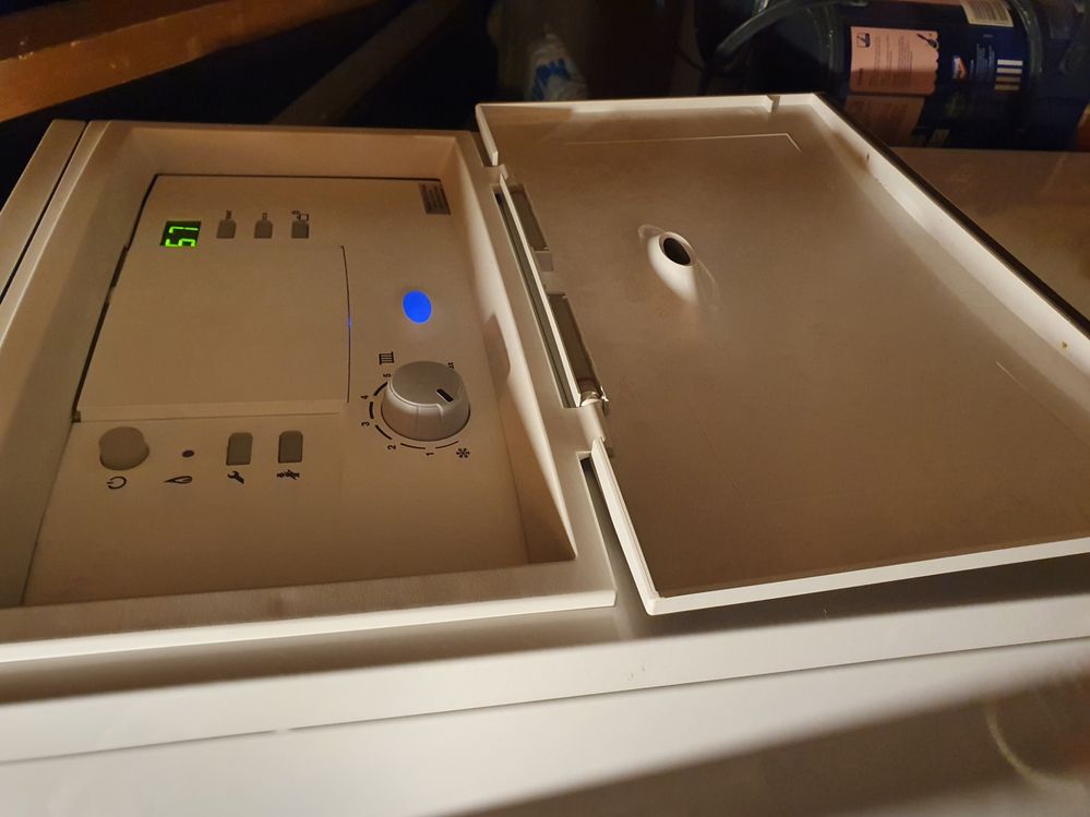

Are you saying that the Nest stops calling for heat (does not glow orange) when it reaches its target temperature but the boiler does not stop and you have to switch it off at the breaker? What is your hvac system? (Boiler/radiators, electric forced air etc). Please also post a picture of your wiring base and the Nest model your are using.

Yes, that's right. I have a worcestor combi boiler and radiaters.

Hi Laurent, I would welcome your thoughts on my pictures and reply as my nest is still not working.
thanks

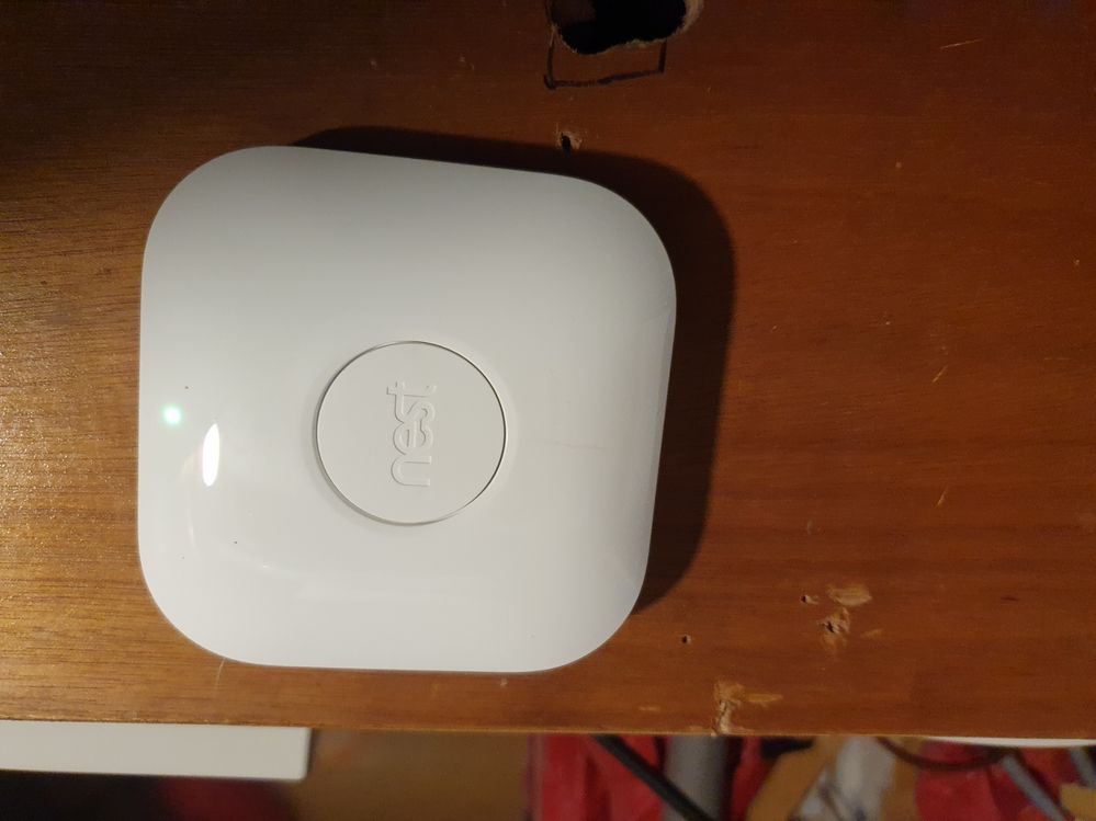

I have checked the heat link. It is switched on. I re-set it and it came back on. When I adjust the nest thermostat between heating on and off, the heat link makes a clicking noise as though it is responding to the thermostat. However, it has no effect on the boiler.

Your heat link is most likely not wired properly to your boiler. It is usually 4 wires, 2 for power with live (L) and neutral (N), and 2 control wires usually on terminal 2 and 3, depending on your type of boiler. Was the Nest installed by a professional?

Yes considering this is most likely a heatlink issue I recommend you have it diagnosed by an HVAC professional unless you are proficient in electrical.
