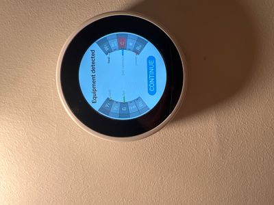

I am replacing a nest thermostat with a nest learning thermostat and when I attach  the new one to the wall it will not power on to finish set up. I have checked that all of the wires are inserted properly and pulled it off and connected it to a USB to make sure the battery is charged. Please advise next steps. Thanks

Thanks so much for replying. I previously had a regular nest thermostat installed, and I installed a google  c wire power adapter on the ac unit last year. All was working perfectly. I am trying to upgrade to a google nest learning thermostat and it keeps telling me that there is no power to the c wire.

 I can’t figure out how to move past this error so that I can see if I need to update the wire settings. Thanks!
Do you have access to a multimeter so you could check power? I would check for AC power between the red wire and the C wire. Since you have a blue conductor being used for your C wire, there’s no need to have a Nest Power Adapter.  Make sure that the blue wire at your attic unit is directly connected to the C terminal on the control board.

Thank you so much for taking the time to reply! We removed the power adapter and hooked up the c wire directly and it worked!!!! I appreciate you taking the time to help me fix this! Thank you, Thank you!
