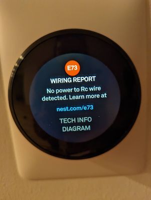

I have a heat pump in my new place and tried installing a Nest Learning Thermostat. I keep getting an error saying no power to the Rc wire.
I put my old thermostat on and it works fine. I also know other people in this building have a Nest thermostat, so it's not the building.
I've attached pictures of the old wiring, new wiring, wiring diagram on the Nest, and the error report.
(I also tried the Rc wire in the Rh hole.)

The common wire may not be properly grounded, so the system uses power sharing but doesn’t get enough energy, which shows no power. Could you please gather the power readouts under Technical Info with and without C-wire connected? Turn off the power to your HVAC system at the breaker box before touching the wires.
