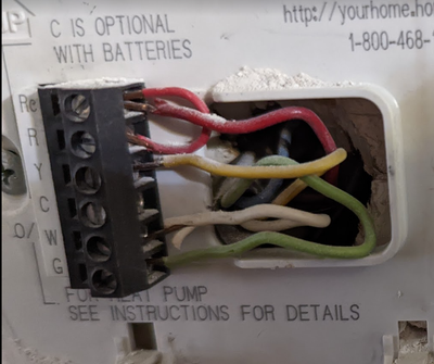

I am trying to install a nest thermostat to an old system.  Here is a picture of the wiring in my old thermostat:
There is a bridge between Rc and R, and the red wire goes in Rc.  Y, W, and G.  All pretty standard from what I'm seeing online.  I do not have an O/B wire.  When I install the Nest (Gen 1), I put all the wires in their corresponding positions.  In the app I say that I have an Rc, Y, W and G wires.  Everything sets up, but it is blowing hot air when it should be cooling.  I did some checking and all the solutions say to mess with settings on the O/B wire, which I don't have.  I thought, maybe I should just say R instead of Rc.  I factory reset and re-did everything but said R instead of Rc.  Now I get an E294 error saying there is no power.  Below is a screenshot of my first configuration in the Google Home app:

Thanks for reaching out here in the Google Nest Community and for sharing these photos.
From the first photo, it seems that it is a conventional HVAC system and it should be wired the same way to the Nest Thermostat. I can also see a blue wire (unused) from the back. This could be a common wire that we can use and connect to the C terminal on the Nest Thermostat.

There is a blue wire back there, but when I connect it, the Nest says it isn't connected to anything.... I think.  It's been a while.  I'll have to see if I can get my landlord to set up the C wire.  It's been working great for the past couple weeks.
MelbaDT
I understand. You might need to trace where the spare blue wire is connected on your HVAC's control board just to cover all the bases. Also, you could reach out to your landlord instead for the option of setting up a C wire.
