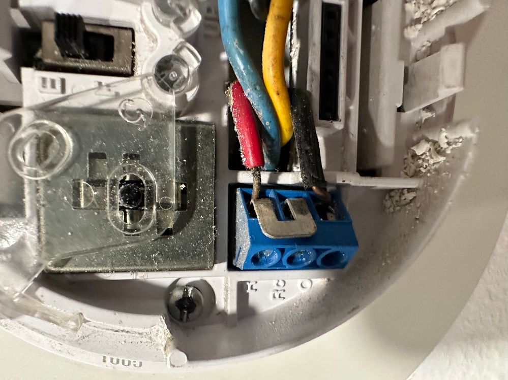

Hi Our New place have an old Honeywell round 1H/1C thermostat. Its hard to on/off and get temp setting straight. Was looking to have it replaced with a SMART thermostat. When checking the compatibility, it was suggested to post a picture. Please advise what would be the most compatibility with digital /wifi/smart for the below wiring config

Thanks for posting here in the Community forum and for showing interest in our Nest Thermostats. Are you located in North America or Europe? Also, to get a better understanding of how your thermostat wires are connected to your current thermostat, list them down, as the picture can't clearly tell.
Thank you Zoe. . Its hard to on/off and get temp setting straight. Was looking to have it replaced with a SMART thermostat. Please find below more pictures, Hope this helps

Thanks for getting back to us, and I'm sorry for the late response. Fortunately, your thermostat wires are compatible with either the Nest Learning Thermostat 3rd generation or the Nest Thermostat E and should be wired to the Nest Thermostat base as follows:
  • Yellow wire to Y1
  • Green wire to G
  • Red wire to Rc or R
  • Black wire to OB

Thank you Zoe. . Its hard to on/off and get temp setting straight. Was looking to have it replaced with a SMART thermostat. Please find below more pictures, Hope this helpsIMG_9100.jpgIMG_9101.jpgIMG_9102.jpgIMG_9103.jpgIMG_9083.jpg
