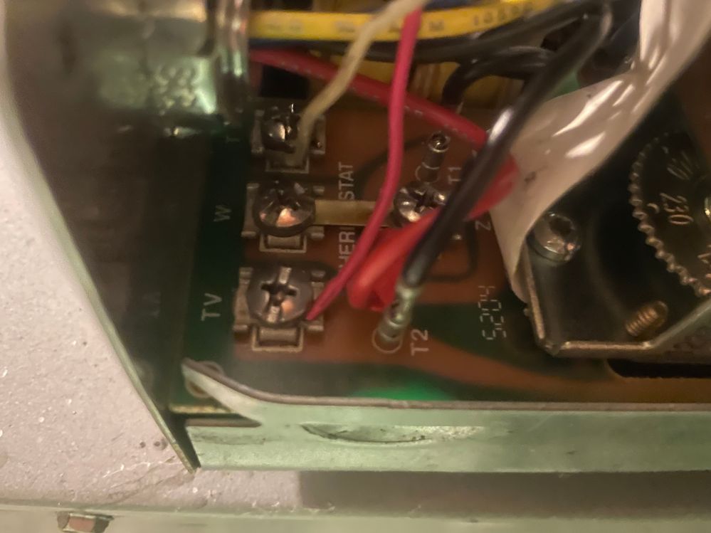

Regarding your two Nest Thermostat that feel warm to touch, there are other things that might cause this. Please answer the following:
  1. Are you from North America or Europe?
  2. Which Nest thermostat you have?
  3. When did the issue start?
  4. Send a picture of your current wiring.
Keep me posted.
Renz

Jprokash
We are using a boiler heater so it is only a three wire system.  The R and W for the heater relay and the C for power coming from in unit 24V transformer. I disconnected the c wire just now after reading more about it online and it seems to be reading the correct temperature now.  For whatever reason the power coming from the transformer on the C wire was coming to the thermostat at 28.4V despite it being a 24V transformer.  I suspect that this extra voltage may have been what was heating the thermostat.  If I am running the unit with only the R and W wires does that mean it the thermostat itself is now only powered by the battery? Would this be a case where the power connector could be useful?
Jprokash
Now that I have disconnected the C wire. I have attempted to do a factory reset just to see if it provided any error messages and it seems that it is requiring a C wire power connector if I am planning to run the thermostat with just the R and W wires.  The original issue we had was that when the when we had connected the Nest at the start it was giving a warning that there was too much power. The transformer in the heater was not working properly so we bought a new 24V transformer(This is the new transformer that is now sending 28.4V).  We connected the C wire through this new transformer.  After doing this the thermostat would connect and seemed to work as intended except that it reads 15-20 degrees above the actual temperature.  If I go through the whole process with the three wires connected and this 24V(sending 28.4V) transformer and then just disconnect the C wire from my heater after the setup the thermostat temperature reading drops back down to normal. If I just leave this C wire disconnected will the battery just die? Or is it ok to run it without the C wire? I bought the google C wire Power connector but don't know that it will be any help because it seems that this voltage coming from the transformer may be the issue.  Any advice would be greatly appreciated.
