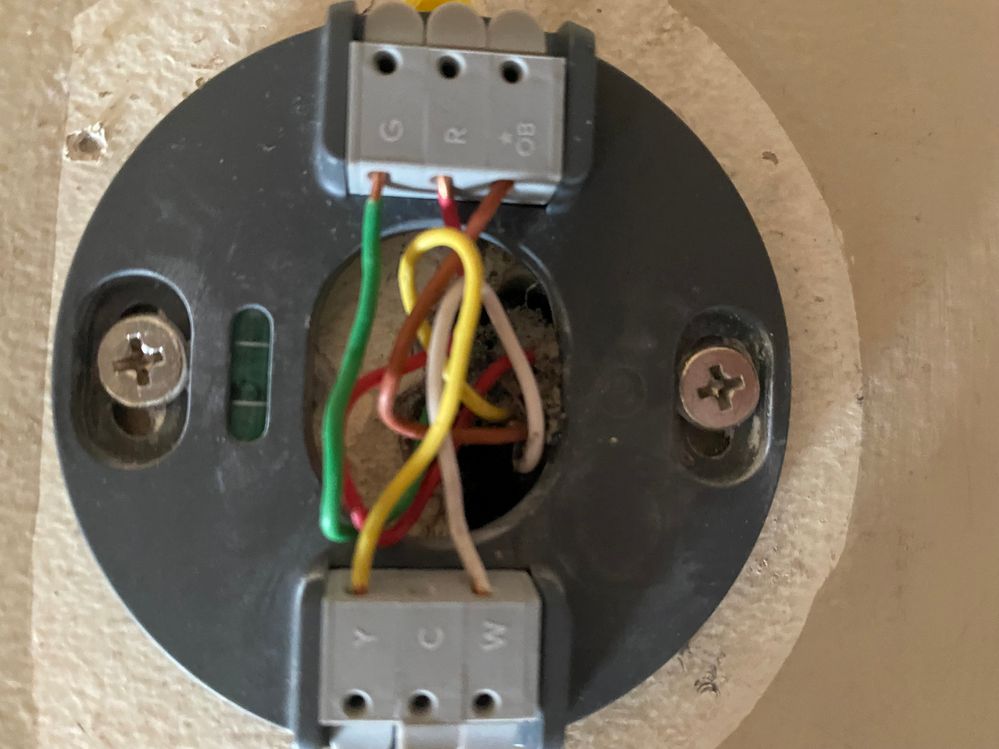

New install and AC works great..when heat is turned on..the fan blows but does not light the gas.  I have a American Standard Gas Pack.   Here is a pic of the wires when attached to old thermostatIMG_3903.jpg

Did you wire it something like this?
Red - R to R
White - W1 to W (jumper toW2/X2 not needed)
Yellow Y to Y
Green - G to G
Brown - B to C
I did the following
Red - R
White - W
Yellow - y
Green  -G  (says it does not see connected on reset/resetup)
Brown - B not to C
Should Brown go to C and not B?
Yes, move the brown wire to the C terminal.
If you are still not sure, you can look at the terminal block on the control board in the furnace/air handler and see where the brown wire connects

Scedarst
Didnt work with my dual fuel/all in one gas pack...connected to my heat pump only upstairs unit and it works great

Thanks for the update. I am glad to hear that it works now on your heat pump system. As for your dual fuel one, you will need to have a trained professional set it up. It’s important for a professional to assess the requirements for your specific dual fuel configuration since choosing incorrect options for a dual fuel system can result in damage to your system. We recommend to contact a local pro.
