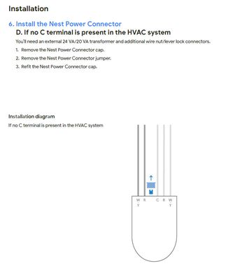

Unfortenitly the Google Nest Thermostat (2020) does not support an external 24VAC transformer by it's self, only the Nest Learning Thermostat support an external Transformer.
The Thermostat (2020) will support one when used with the Google Nest Power Connector.
