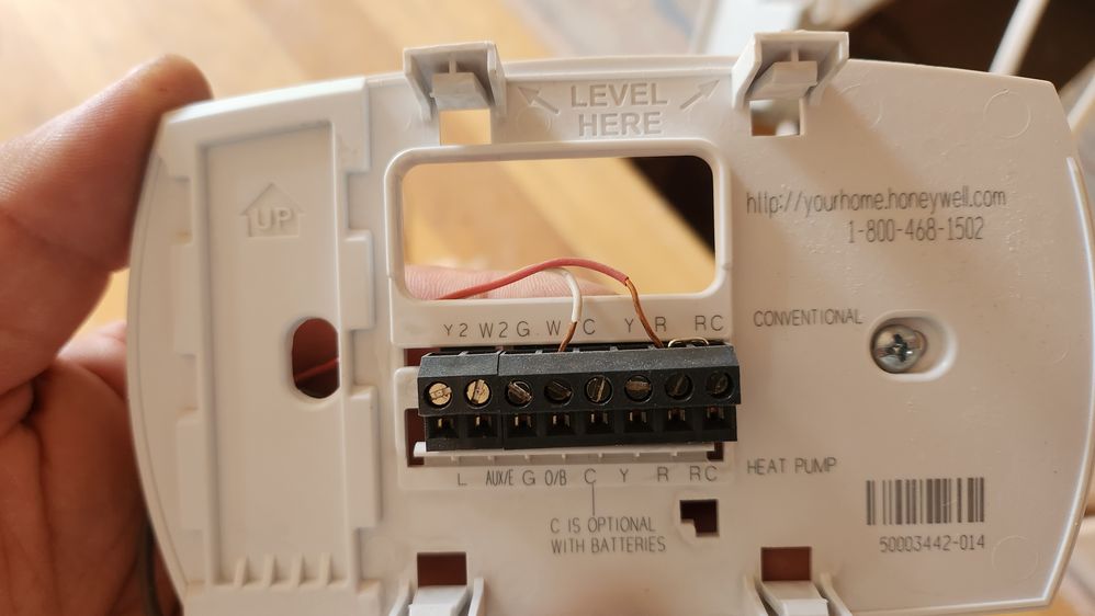

I am trying to see is the nest thermostat or E (not learning) is compatible with my system. I have 5 zones so I need  thermostats.
I have two wires attached to the thermostats. W and R only. These are low voltage.

HVAC technician here... You can use the Nest E thermostat for each zone as it doesnt require a C terminal. Although it's a huge expense for a simple on/off radiant heat only system. You may go through batteries like crazy though without both a R and C terminal which powers the stat normally.

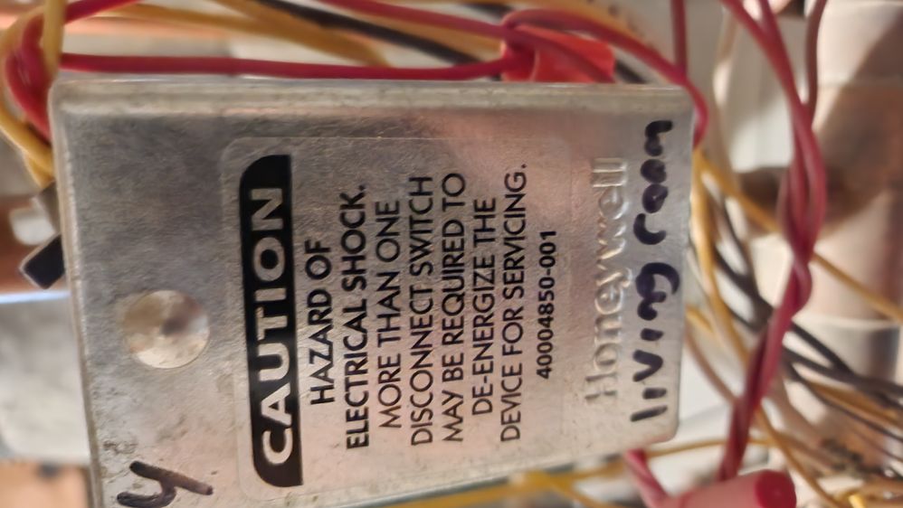

@HAP1, in addition to what was shared above, the Nest Thermostats are compatible with zoned system panels. But some zone relays don't provide enough power to the thermostat. In most cases, it needs the Nest Power Connector or a Common wire to deliver constant power.
