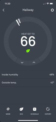

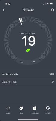

Mohsin82
Hi @Vladut , this is what is showing on the app.

Mohsin82
Hi @AlexD @Vladut  I checked her app again on her iPhone and when moving the slider a few steps down it then shows up with the current temperature. The same happens in Fahrenheit, I've attached screenshots to show. When moving the slider closer then the current temperature does not show.
