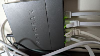

09-29-2022 12:26 PM - edited 09-29-2022 12:58 PM
Hey All,
I've been looking into this issue today. I have a 3 pk original Google Wifi along with an additional google wifi mesh point, 4 total. I also could not get past 100mbps speeds on my 5Gz wifi. I came across this youtube video, https://www.youtube.com/watch?v=RErj-r1lFv4 and he connects one of the mesh points into his ethernet cable and his wifi speeds picked up. I just did this and went from:
to the following:
I'll also say I did change my google wifi's DNS to custom DNS using googles DNS (8.8.8.8 and 8.8.4.4) prior to doing this without much luck but that setting is still in place.
To be clear, current set up:
Fiber Modem > Primary Google Wifi router > Netgear GB dumb switch > Google Wifi Mesh Point (send internet in) > Netgear 2 GB dumb switch
Primary Google Point
Bottom of Primary Google Point
Netgear Dumb Switch (1Gbps)
Google Mesh Point
Netgear Dumb switch 2 (1Gbps)
The above is how my LAN is wired. The important part is plugging in your ethernet cord to a 2nd google wifi mesh point and then to a switch if you have a lot of tech for hard wiring.
I hope this helps!
09-29-2022 02:51 PM
I read this too somewhere to use a router. Does it work if you have fibre modem > router dumb > google wifi?
Seems shocking you need to dumb down the service to get full speed, googles smarts are throttling the service
