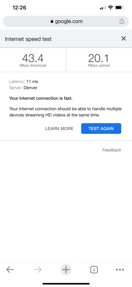

I have 400 mbps internet. My phone is showing 190 on a speed test app I installed. If I change to my modem’s wifi I stead of Google Wifi I get over 400.
This is not correct behavior. I looked in the Google Home app and ran a mesh test with no issue. I see the Google wifi is receiving 445 mbps download.

Dealing with a similar issue here. Google Home Speedtest showing consistently 840-860Mbps down (from Xfinity xfi modem in bridge mode to the Google Mesh.) When less than 2 feet away from the same Google Mesh (that is connected via ether to the xfi), best I can get over wifi is 36Mbps. It's painfully lossy to sub 12Mbps in an adjacent room where there is actually another mesh puck.
This is really poor QoS. I love the Home app / utilities but I should be able to get better bandwidth than this.
