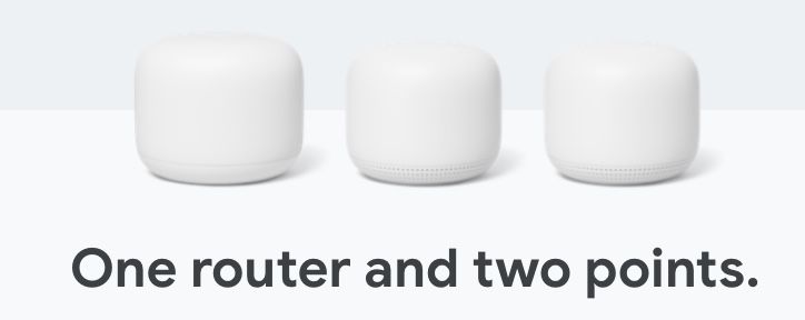

Hi there, I have 3 Nest WIFI Routers and 3 access Points.  Photo below shows 1 router and 2 points, but I would like to utilize the 3 routers and 3 points that I have to maximize my coverage....its a big house on three floors.  I have my Telus modem connected to one router to send out my own WIFI.  I can add the points easily enough but should the routers be used with a cat5 connection to either the WAN or LAN ports and then push out the WIFI signal?   I am able to add all the routers and points on my network wirelessly but would like to know if I should use cat5 connections for the two other routers??  Thanks for your help!  Cheers, Colin8C1CE148-83A0-4C63-A30D-B44B1AD30110_4_5005_c.jpeg

There's a few things you should know about here, before going for wired backhaul.
First, it's not recommended to mix wired backhaul (ethernet cable connected Nest Wifi units) and wireless backhaul. This is because mesh (802.11s) does not travel over ethernet. Mixing backhaul can cause looping issues.
Second, yes Nest Wifi router supports wired backhaul. Setting up a Nest Wifi router as a secondary should be just as setting up a Nest Wifi point. You can even set it up wirelessly first, then connect it by ethernet afterwards.
Third, the maximum recommended amount of Nest Wifi units is five. If wired backhaul only, you can push this further. But the general advice is; the fewer the better. This is due to the additional overhead (Nest Wifi units talking to each other to keep the mesh up) and additional wireless interference introduced by every additional unit. More on that:
