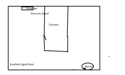

Arunm
Drawn image to show the real scenario
Ashepherdson
Yeah so the furnace (and probably the duct work attached to it) are blocking the signal, I am not too surprised they are basically large faraday cages

Arunm
Sorry about the late reply. If I keep another nest point in basement perpendicular to the NEST router will it help ?
Thanks
Ashepherdson
It's possible it may help, but the proximity of the furnace and duct work does make it more difficult.  If that area is unfinished, I would strongly recommend running ethernet cable to the projector, which would give you full speed with no interference.
