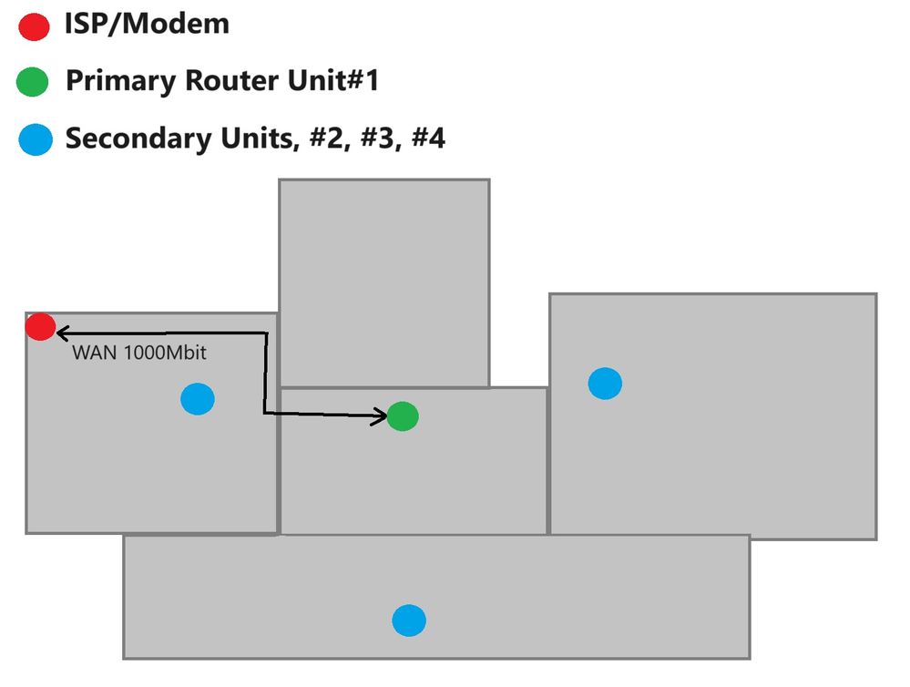

In my case the ISP/modem is on the corner of my property, putting the primary unit near it does not make much sense as that would mean everything would be leaning towards the corner of my desired wifi area.   So what I will probably do is run a long WAN wire to the primary so that it can be located in the center of the coverage area.   That way the extra units can act like satellites, or extenders to the signal.
Here is a sketch of what I plan to do:
My Mesh LayoutMy Mesh Layout
Running a cable to get the primary located in the center is an excellent plan, especially if you can't wire the secondaries to it.
