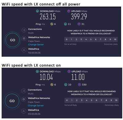

Hey Community. I've been tearing my hair out and I don't have much to start with 😂 and reaching out for support from Cape Town. Here's my problem: I've purchased a wonderful wireless speaker system (Mission LX Connect - see link below) for my office setup and my WiFi speeds have dropped from 500 Mbps to 15 Mbps!! - see Speedtest.net screenshots below.

I have a good Fibre connection, a 3 piece Nest Wifi set-up with my modem and mesh router on my table. The speakers are on either side of my MacBook and monitor. The LX Connect signal is uncompressed 5.8 GHz. My understanding is that the Nest operates on 2.4 and 5 GHz bands with all bands active simultaneously and the bands cannot be split. When connecting to my ZyXEL modem/router (only on 2.4)  WiFi, the signal improves marginally to 50 Mbps, but still a long way off what the fibre connection is capable of. I'm able to change the channels on the ZyXEL but not on the Nest? There seems to be interference, possibly due to the closeness of the 5.8 and 5 GHz bands? Unfortunately I'm a psychologist and my tech skills are not able to solution around this 😂. At least I can provide my own self-help counselling to address my current state of depression!
I believe that the Nest Pro adds another 6 GHz band which may alleviate the current signal conflict, but I'd prefer to have a solution with my current set-up if possible. The sound is amazing, but if this problem persists, I'll need to prioritise my WiFi speed for my business operations and send the speakers back, plunging me in to even  deeper depression 😎 . Any ideas would be highly appreciated. Thanks, Keith
