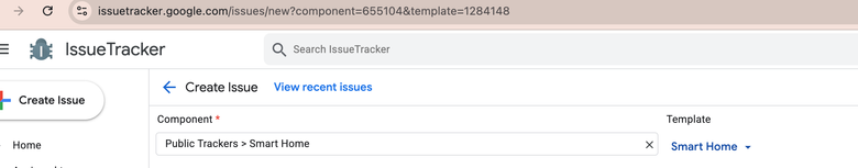

Thanks for sharing, we can repro the issue on our end. Could you please open an issue tracker (Public Trackers > Smart Home) and share the bug ID here. Provide all the details from above along with the feedback from the Google Home app. I will forward it to internal teams for further investigation.
