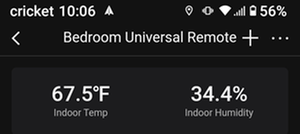

04-02-2023 06:53 PM
Here's my BroadLink app and my Google Home app:
From BroadLink app
From Google Home
As you can see, temperature is not displayed, but humidity is.

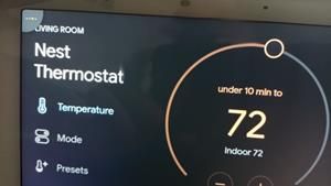

lol well at least you can get Google assistant to tell you the temp since I see you use Celsius. You seem to have the same issue as everyone else .. it doesn't show the temp but if you say Hey Google whats the temperature downstairs it will tell you its 18.9C. Others that have this issue that use Fahrenheit also don't show the temp on Home but if they ask for the temp google will tell them in Celsius even if everything is set for Fahrenheit
yes the hub does show temperature but for those of us in the USA it shows the wrong format even if Fahrenheit is selected in the BroadLink app and Google nest hub and assistant are also set to Fahrenheit.
So... yes the Hub sort of works for you but .. actually The Hub is screwed up with its display too. The Temperature shows a big number and then a smaller "current" number but the Humidity shows a big 0% and then a "current" with the actual humidity (or at least this is how it is on my 3 nest hubs). I'm assuming yours are acting the same way.

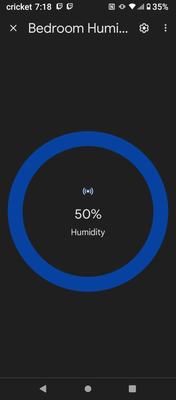

06-15-2023 07:18 AM
I don't know what happended but suddenly start working. I'm seeing temp and humidity in Google Home.
06-15-2023 09:44 AM
Google Home is showing me both, humidity and temperature.
06-16-2023 10:02 AM
Holy smokes, I can confirm that it looks like Google actually (mostly) fixed this issue! Using Home app public preview version 3.2.1.7 that just became available for me this morning. Google Home *app* now shows the temperature from Broadlink. Granted it is showing it in Celsius even though every other setting in both Google and Broadlink is set to Farenheit, but at least it now exists so I can set routines around it. It took far too long for Google to finally address this issue for such a widely used product group as Broadlink, but credit where credit is due to the big G. Thank you Google developers, wherever you may be (now just try and get the units right 🙂

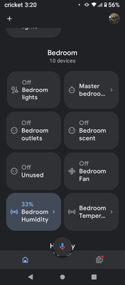

06-15-2023 04:51 PM
I guess I'm missing something because nothing has changed since the beginning .. or at least since December of last year. There was a update to Google Home .. and ... nothing changed in that app .. the temp still does not show and the Hub always showed Celsius and still does .. so .. again .. nothing has changed even with the new app so I don't know what you people have seen but there is no change in the operation of the systems (Google Hub, Google Assistant and other than the change in the app... Google Home)
as you see .. .. new app and still the same readings .. Bedroom and living room Humidity and both bedroom and living room temps are blank and when you press on them you get that other window with device settings instead of like when you tap on humidity it brings to to a screen that shows the humidity (though redundant) The 81 you see in the living room temp is my nest thermostat. The Broadlink sensors for temp are both blank. I think people are looking at it wrong and its still the same as it used to be .. if not .. do me a favor and take a screenshot of Google Home that shows the Broadlink sensor in Google Home showing the temp. .. I guess some people feel they got it running but .. again .. nothing has changed .. the only thing I can think of is maybe you guys are using Apple and not Android ... I would need to see some actual screenshots of this working because I don't really think anything has been touched with this by either companies.

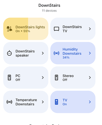

Hi mate. Not sure how to show a pic on here but since the google home app update on my Samsung S23 Ultra I can now see temp, in Celsius, in the home app on my phone..it has never worked before the update. I don't know how to share a pic on here or I'd happily show you.
06-15-2023 05:07 PM - edited 06-15-2023 05:15 PM
(Oops sorry didn't see that it was a samsung lol) Is it an Apple phone or Android? You can share a picture by clicking on the camera icon in the reply box where you type in the text... then you open windows explorer and find the picture and just drag and drop it in the box that shows up when you click the camera icon. (If you are doing this from your phone I'm not sure if the process is the same) But .. I guess it is more important to know if its an Apple phone .. maybe for some reason Google is working better on an Apple? .. I just showed pictures of my google home and it is the newer version and nothing at all has changed.... maybe if its not Apple... maybe it's a location thing .. maybe they haven't fixed it in the US yet (which seems odd)
06-15-2023 05:17 PM
A Samsung S23 Ultra is not Apple hehe I don't appear to have a camera icon 😥
06-15-2023 05:26 PM
lol yeah oops its getting late for me and my head isn't fully there lol ... I noticed it a bit too late .. and I guess the phone interface for replying here is different.. I have been using the desktop / website to do replies .. no matter .. I guess I'll take peoples' word for it since I'm assuming they came here because it didn't show .. so now if you are seeing it on Google Home .. I guess I will just wait and see ... though I think I'm going to have to leave the Google ecosystem since they just killed AutoVoice and I use that for my security system.. that is more important to me than having a temp sensor working .. or humidity not working if I have to go to Alexa
06-15-2023 05:20 PM
06-15-2023 06:05 PM
thank you for taking the time and replying with a screenshot 🙂 .. ok .. I'm going to have to look into my next theory. I think it may not be showing on mine because I use Fahrenheit and Google is broken with this device when it comes to using Fahrenheit. It had the issue with Google Hub also .. it shows the Temp on google hub but only in Celsius even if everything is set to Fahrenheit and even Google Assistant announces the temp in Celsius even when the Broadlink app is set to Fahrenheit. I just need to figure out how to set "google" to Celsius to check the theory.
