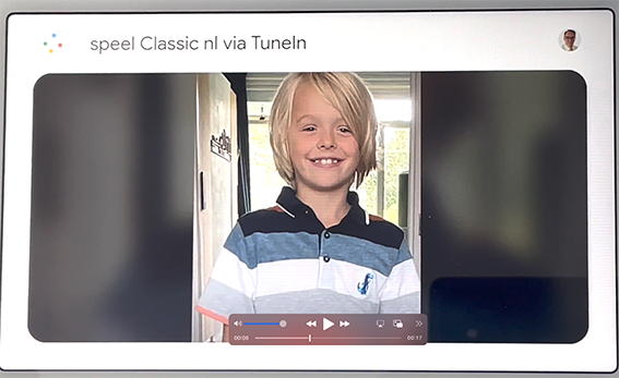

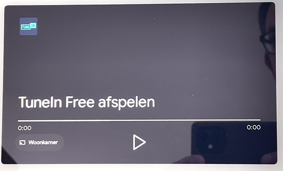

06-12-2022 12:36 AM
No I haven't because it seems to be a Google Assistant issue, since it DOES work with voice commands on my smartphone. Some background info:
It looks like Google Assistant on external devices sees "ClassicNL" as an alias for "ClassicFM" (rather than the other way around) and no longer finds the Dutch ClassicNL but only the Haitian Classic FM. I do not have an explanation why it DOES work correctly on my smartphone.
06-12-2022 12:46 AM
Extra info:
