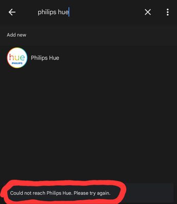

I had all my lights connected to Philips Hue and Google Home. And I got two new ones which I paired with Philips Hue, but they didn't show up in Google Home. I tried to do "sync all devices" or "sync my devices" but after 48 hours still not showing up. So I did a terrible thing and unlinked Philips Hue from Google Home and now I can not link them back again no matter what I try.
I have done these things:
- I am connected to same WiFi with my Samsung Galaxy S23 as Philips Hue.
- I have checked if both apps are up to date, and they are.
- I have cleared and removed all integrations between Philips and Google on both sites. Then tried again, same error.
- I created a new account on Philips, added Hue Bridge to that account and added that account as a member of the family with administrator priviliges. And tried to connect Google Home to Philips Hue with the new account, still same error.
- I deleted the new lights in case they were the issue, and tried again, same error.
- I restarted Philips Hue, uninstalled Google Home and Google Assistant, and tried again, still same error.
- I created a new 2,4GHz WiFi network and connected Philips Hue directly by cable to it, and connected my phone to same network, and tried again, same error.
- I tried these methods from both Google Home and Assistant.
- I tried all these methods again with my Samsung Galaxy S21 with newest updat to Androind and both apps. Same error happened there.
- I read somewhere that trying with iPhone solved the issue. I borrowed and iPhone and tried same things with that, same error as well.

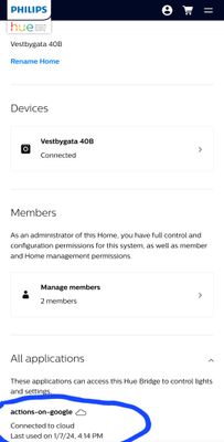

- The frustrating part is that Google is showing as a 3rd part app/service when I check what/who has access to Philips Hue. And everytime I clear the integrations and try to link them back again, I can see on my Philips account that Google asked for permission and permission was granted, and even the time Google tried first and second and third time...
The only thing I didn't try is to reset the Hue bridge because that will take a lot of time for me to bring all the lights and scenes back to normal again, and tbh if I would try to reset the bridge I might as well go over to Homey and link everything with it.

I tried to see where these procedures stop, so I did the same procedures via local WiFi again, and it looks like Philips giving the permissions and everytime Google ask again it shows on Philips account that Google used Philips Hue and all the logs and timestamp are correct, that why I think the problem is within Google servers and with the partner integration within the cloud...
Also, I tried same procedures while I was outside the house and it had same results...

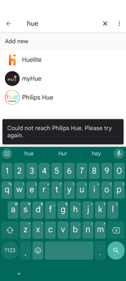

Similar situation, tried a lot of the same things, getting the same error - Philips says it has given permission, but Google doesn't seem to recognize it.Screenshot_20240130-092435.png
 I have tried chatting with Philips Hue via Facebook but without progress.
