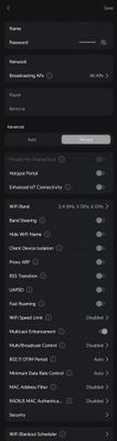

Using Googe Nest/Wifi mesh by chance?  I 12 ish nest speakers and 3 hubs.  I was ready to gut the entire system.
Started the process by replacing Nest Wifi mesh with TPlink Deco... Since doing that - no issues since. Been about 3 months now.
That's about when the hubs were fixed.
Maybe?  But i went from trash to functional the same day.  I mean - its not like google has provided any feedback or guidance on the issue what so ever.  So the perception to me was - this fixed it.
IMO - if you are done with google and ready to gut everything google.  Start with your google WIFI...
