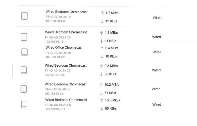

"Group Leader"
Kelan in his recommended above answer wrote…. “Note: the issue must be fixed on the device that is the leader of the group in order for the other devices in the group to start playing consistently”. Multiple people asked repeatedly how do we know which device is the leader, but no response was ever given.
Turns out the leader of the group sends out data to the others in the group. The non leader speakers download at a rate of 280_kb/s - 310_kbs/s from the Group Leader. The group leader uploads at 1.5_mb/s to 2.5_mb/s normally. When things start going wrong the upload speed goes up and up till it chokes itself out, see pics below of screen grabs of this happening.
CastLeader.jpgIf you notice it says wired, the leader along with 7 more speakers are hard wired in the group of 13 speakers. I have setup 3 different routers over the past 2 years to the tune of over $1,200.00 and it has absolutely nothing to do with wifi!
