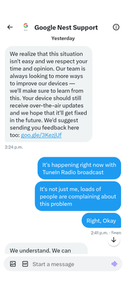

07-18-2023 02:06 AM - edited 09-24-2023 12:51 PM
I've tried all the above and more. There is no fix. Google know about this. See the concluding Nest support exchange attached.

I reached out to device support and referenced this thread of discussion. They seem unwilling to acknowledge the problem. Here is their reply.
From hardware support:
I understand. But we'll need to ask for a video showing the issue so that we can use the video to request a replacement for your device if ever our senior team can confirm that it's a hardware issue that's causing the problem. We'll also need to get its serial number to check the warranty status. You can upload the video of your device showing the issue to photos.google.com or the Google Photos app. At least 45 seconds should be enough.

Support requested me to send them some more information. Below are the instructions given to me. I sent them the feedback after I heard the popping sound. They said they will provide an update soon.
From support:
I just got an update with our senior team. They're still working on a stable fix for the issue. They're also asking you to replicate the issue wherein it would give a popping sound. Once it does the issue again, please send feedback by saying "Hey Google, send feedback" then indicate the keywords"GHT3 34502 Google Nest speakers produces random popping/clicking sounds".

I responded to support last night as a result of not hearing anything back for two weeks. They replied with the message below. I am aware that the ultrasound sensing is not the root cause of the problem as reported by some users. I will give it a try but not hoping for much.
== response from support ==
Thanks for your response. I apologize for the late update. Our senior team just provided an update. Most users affected with this issue were able to get the problem fixed by turning off the ultrasound sensing of their Google Nest Mini. Please try switching it off, here are the steps.
