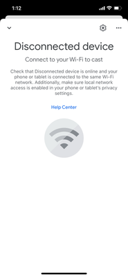

I’m having a similar problem. I have 2 chromecast (1 in the bedroom and 1 in the lounge) and a week or two ago they just stopped working. I’ve tried all the suggestions multiple times and it just won’t work.
The Google home app can see the devices but says the following
Disconnected device
Connect to your Wi-Fi to cast
Check that Disconnected device is online and your phone or tablet is connected to the same Wi-Fi network. Additionally, make sure local network access is enabled in your phone or tablet's privacy settings.
I’ve done all of these things multiple times and it’s just not working. I don’t know why it says it’s not connected to the local network (which I’ve checked in local network that it has permission) as it’s showing photos from Google on my tv! It’s like my iPhone and chromecast just won’t communicate any more. I e also tried to connect using the Google home app on my Samsung tablet and it’s doing the same thing! It’s frustrating as it’s been working fine for 6 months since I bought them and now I can’t cast!

@Serinayde, I’m sorry for the trouble — let’s check. Are there any changes made to the network? Are you using a dual band router (2.4GHz, 5GHz)? If so, which band is your Chromecast connected to?

Hi Serinayde,
Thank you for the details. Based on the screenshot you sent, the Chromecast device is connected to Wi-Fi, which shows the Ambient mode. Your Chromecast is on 2.4 GHz and since the Google Home app is not detecting it, your phone may need to be on the same band.
Give the steps below a try and let me know how it goes:
  • From your phone’s settings, toggle Wi-Fi off and on.
  • Switch off cellular data.
  • Forget all networks and reconnect to your 2.4 GHz band.
  • Reboot your phone, Chromecast, and Wi-Fi router.
