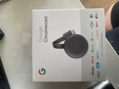

 I don’t know if it’s Gen 3, but this is the box it came in

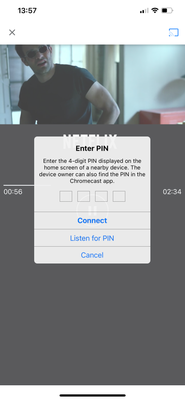

 All goes well and everything is connected to the same wifi. When it gets to the tutorial of how to cast, it’s asking for a 4 digit code, but it doesn’t display this anywhere and there is nothing in the app that shows me the code either?

JenniferV
Hi Henry4,
Thanks for getting back to us. It looks like it's asking for the 4 digit guest mode pin. Could you please check if the guest mode setting is turned on? See the steps below:
  1. Make sure your mobile device or tablet is linked to the same account as your Chromecast.
  2. Open the Google Home app.
  3. Touch and hold your device's tile.
  4. At the top right, tap Settings  > Recognition & sharing > Guest mode.
  5. Turn off Guest mode.
After you turn it off, reboot your mobile phone and make sure it is connected to the same Wi-Fi network as your Chromecast then try again.

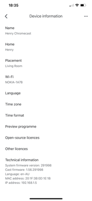

Henry4
 that’s my Chromecast information
 and that’s my wifi connected to the same wifi
