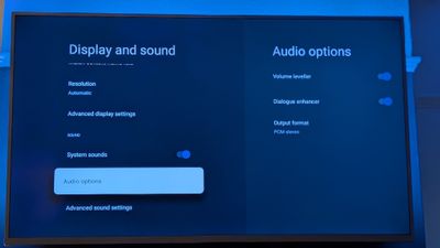

Scott_Edy
Have you tried the new setting that came in the update? Switching to "PCM stereo" under "Output Format".

What apps have the delay?  Is it system wide?  How is the streamer plugged into the tv, is it plugged into the receiver?  Have you tried plugging it directly into the tv ?  I'm using mine with a Samsung OLED and there is zero latency, so it's not a system wide thing, it's got to be hardware or a specific setting.
You're right in both counts I feel. It's a Dolby encoding issue. Mine is system wide i.e. no matter the app, it's the same (audio delay).  This PCS option sorted it. But it's an obvious sound quality difference when watching immersive features (John Wick for example). The sound just isn't as good at throwing, if you know what I mean
